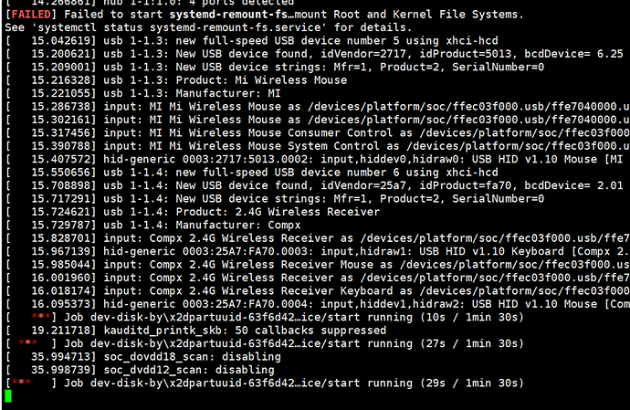

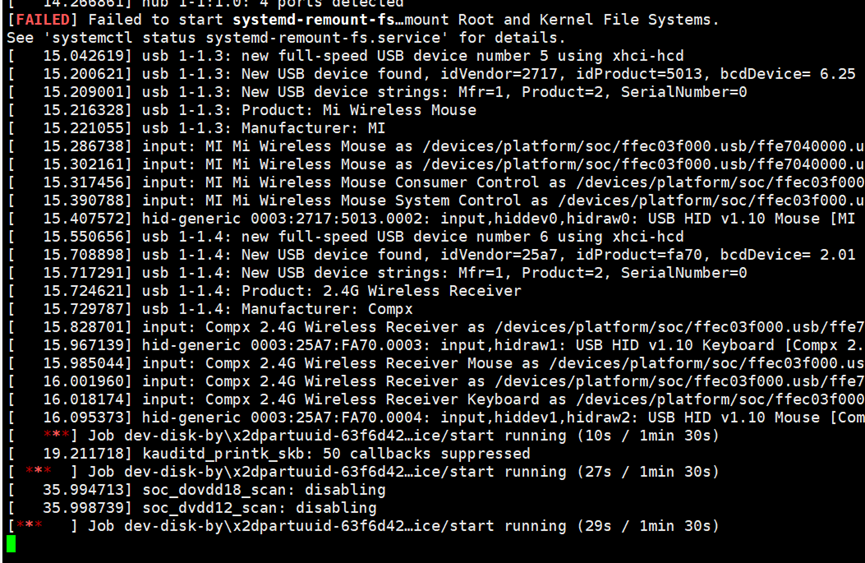

/boot分区内核启动参数,分区UUID,需要和sd卡分区uuid 匹配
/etc/fstab挂载分区需要和sd卡分区uuid 匹配

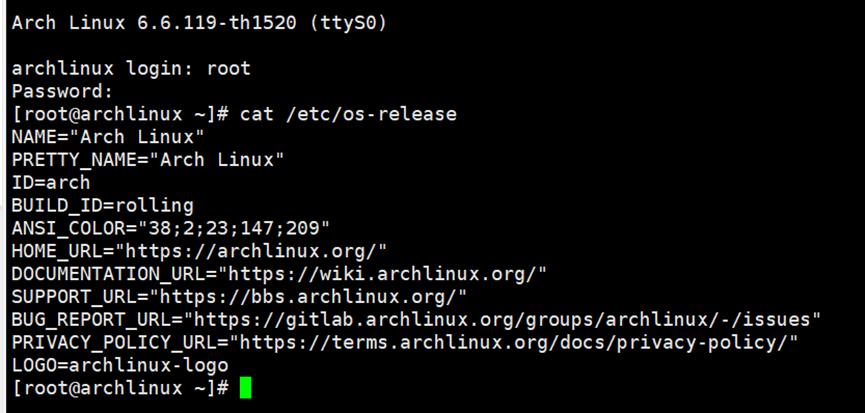

再次启动,截取日志片 段,kernel使用备份的GPT识别到两个分区并成功启动,可以看到sd卡中的archlinux
[ 5.4853 15] Freeing unused kernel image (initmem) m emory: 2752K
[ 5.491 327] Run /init as init process
Loading, please wait…
[ 5.528013] m mc1: new ultra high speed SDR104 SDHC card at ad dress 0001
[ 5.535636] mmcblk1: mmc1:0001 SD 29.2 GiB
[ 5.548432] Primary GPT is in valid , using alternate GPT.
[ 5.553961] mmcblk1: p1 p2
