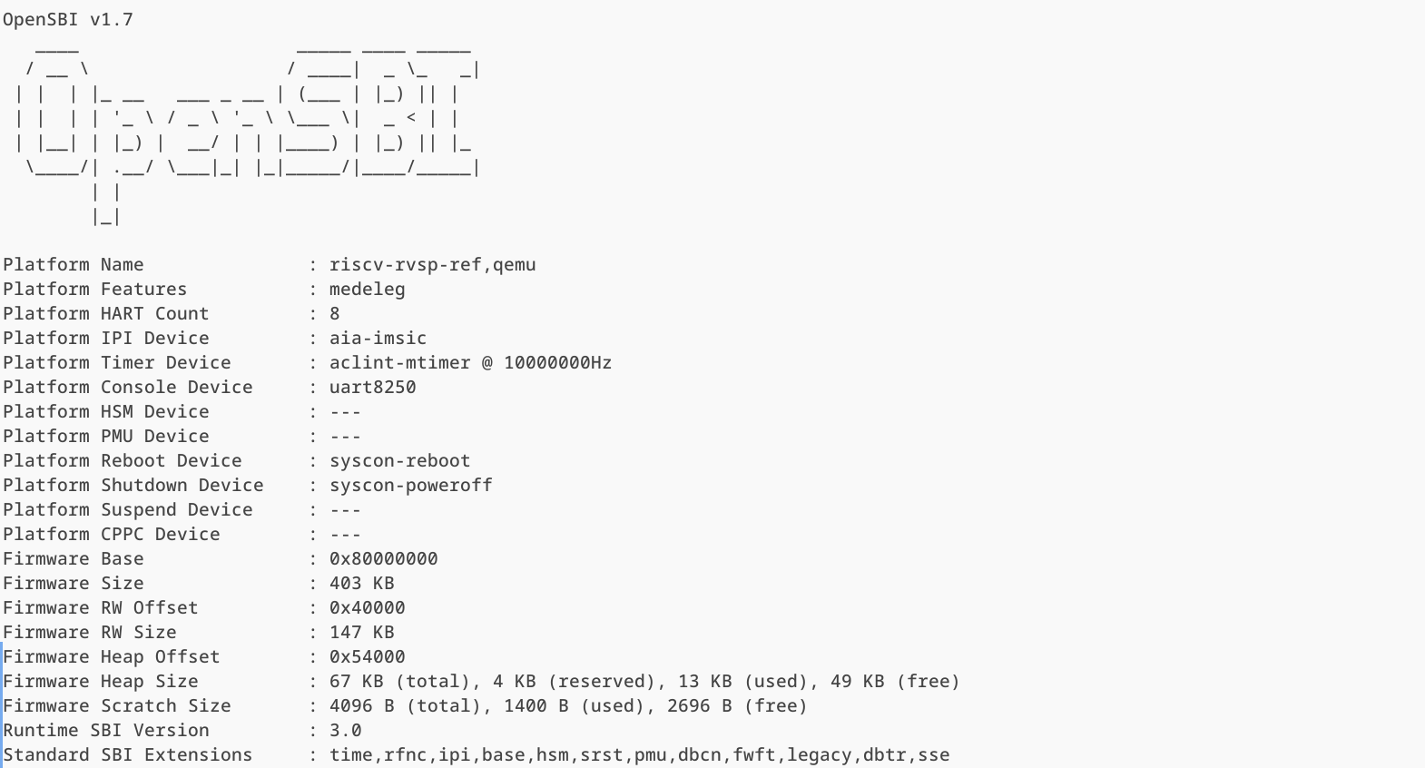

下面截取一些关键输出:
OpenSBI v1.7
   ____                    _____ ____ _____
  / __ \                  / ____|  _ \_   _|
 | |  | |_ __   ___ _ __ | (___ | |_) || |
 | |  | | '_ \ / _ \ '_ \ \___ \|  _ < | |
 | |__| | |_) |  __/ | | |____) | |_) || |_
  \____/| .__/ \___|_| |_|_____/|____/_____|
        |_|
Platform Name               : riscv-rvsp-ref,qemu # 这里显示 rvsp-ref
Platform Features           : medeleg
Platform HART Count         : 8
Platform IPI Device         : aia-imsic # 使用的是 aia 高级中断
Platform Timer Device       : aclint-mtimer @ 10000000Hz
Platform Console Device     : uart8250
Platform HSM Device         : ---
Platform PMU Device         : ---
Platform Reboot Device      : syscon-reboot
Platform Shutdown Device    : syscon-poweroff
Platform Suspend Device     : ---
Platform CPPC Device        : ---
Firmware Base               : 0x80000000
Firmware Size               : 403 KB
Firmware RW Offset          : 0x40000
Firmware RW Size            : 147 KB
Firmware Heap Offset        : 0x54000
Firmware Heap Size          : 67 KB (total), 4 KB (reserved), 13 KB (used), 49 KB (free)
Firmware Scratch Size       : 4096 B (total), 1400 B (used), 2696 B (free)
Runtime SBI Version         : 3.0
Standard SBI Extensions     : time,rfnc,ipi,base,hsm,srst,pmu,dbcn,fwft,legacy,dbtr,sse
Experimental SBI Extensions : none
Domain0 Name                : root
Domain0 Boot HART           : 1
Domain0 HARTs               : 0*,1*,2*,3*,4*,5*,6*,7*
Domain0 Region00            : 0x0000000000100000-0x0000000000100fff M: (I,R,W) S/U: (R,W)
Domain0 Region01            : 0x0000000010000000-0x0000000010000fff M: (I,R,W) S/U: (R,W)
Domain0 Region02            : 0x0000000002000000-0x0000000002007fff M: (I,R,W) S/U: ()
Domain0 Region03            : 0x000000000c000000-0x000000000c007fff M: (I,R,W) S/U: ()
Domain0 Region04            : 0x0000000024000000-0x0000000024007fff M: (I,R,W) S/U: ()
Domain0 Region05            : 0x0000000080000000-0x000000008003ffff M: (R,X) S/U: ()
Domain0 Region06            : 0x0000000080040000-0x000000008007ffff M: (R,W) S/U: ()
Domain0 Region07            : 0x0000000000000000-0xffffffffffffffff M: () S/U: (R,W,X)
Domain0 Next Address        : 0x0000000020000000
Domain0 Next Arg1           : 0x000000027fe00000
Domain0 Next Mode           : S-mode
Domain0 SysReset            : yes
Domain0 SysSuspend          : yes

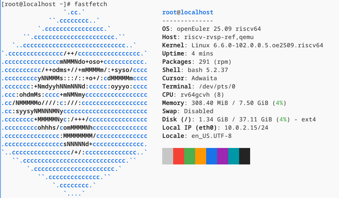

# 成功登录系统以后,可以打印一下信息:
[root@localhost ~]# fastfetch
                 `.cc.`
             ``.cccccccc..`
          `.cccccccccccccccc.`
      ``.cccccccccccccccccccccc.``
   `..cccccccccccccccccccccccccccc..`
`.ccccccccccccccc/++/ccccccccccccccccc.`
.cccccccccccccccmNMMNdo+oso+ccccccccccc.
.cccccccccc/++odms+//+mMMMMm/:+syso/cccc
.cccccccccyNNMMMs:::/::+o+/:cdMMMMMmcccc    root@localhost
.ccccccc:+NmdyyhNNmNNNd:ccccc:oyyyo:cccc    --------------
.ccc:ohdmMs:cccc+mNMNmyccccccccccccccccc    OS: openEuler 25.09 riscv64
.cc/NMMMMMo////:c:///:cccccccccccccccccc    Host: riscv-rvsp-ref,qemu
.cc:syysyNMNNNMNyccccccccccccccccccccccc    Kernel: Linux 6.6.0-102.0.0.5.oe2509.riscv64
.cccccccc+MMMMMNyc:/+++/cccccccccccccccc    Uptime: 56 mins
.cccccccccohhhs/comMMMMNhccccccccccccccc    Packages: 306 (rpm)
.ccccccccccccccc:MMMMMMMM/cccccccccccccc    Shell: bash 5.2.37
.ccccccccccccccccsNNNNNd+cccccccccccccc.    Cursor: Adwaita
`..cccccccccccccccc/+/:cccccccccccccc..`    Terminal: vt220
   ``.cccccccccccccccccccccccccccc.``       CPU: rv64gcvh (8)
       `.cccccccccccccccccccccc.`           Memory: 277.14 MiB / 7.50 GiB
          ``.cccccccccccccc.``              Swap: Disabled
              `.cccccccc.`                  Disk (/): 1.32 GiB / 37.11 GiB
                 `....`                     Local IP (eth0): 10.0.2.15/24
                                            Locale: en_US.UTF-8

亲测可行,成功在 QEMU rvsp-ref 上启动 openEuler RISC-V 25.09 :tada:
